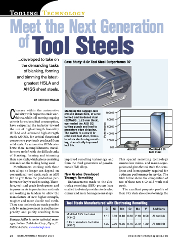

 Case Study: 8 Cr Tool Steel Outperforms D2
  Stamping the luggage-rack crosstie shown here, of a hot formed and hardened steel (22MnB5, 1.25 mm thick), overloaded the AISI D2 cutting punch and lead to premature edge chipping. The switch to a new 8 Cr cold-work tool steel, formu- lated via electroslag remelt- ing, dramatically improved tool life.
  1000% 800% 600% 400% 200%
0%
AISI D2
Modified 8 Cr Tool Steel
                  Tool Steels Manufactured with Electroslag Remelting

 Modified 8 Cr tool steel (K340)
 1.10
 0.90
 0.40
 8.30
 2.10
 0.50
 Al and Nb
 8 Cr + Vanadium tool steel (K360)
 1.30
 0.90
 0.35
 8.75
 2.70
 1.20
 Al and Nb
