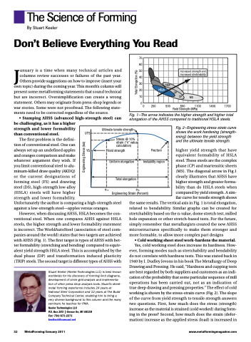

• Stamping AHSS (advanced high-strength steel) can be challenging, as it has a higher
strength and lower formability
than conventional steel.
The first problem is the defini-
tion of conventional steel. One can
always set up an undefined apples
and oranges comparison and make
whatever argument they wish. If
you limit conventional steel to alu-
minum-killed draw quality (AKDQ)
or the current designations of
forming steel (FS) and drawing
steel (DS), high-strength low-alloy
(HSLA) steels will have higher
strength and lower formability.
Unfortunately the author is comparing a high-strength steel against a low-strength steel—apples versus oranges.
However, when discussing AHSS, HSLA becomes the con- ventional steel. When one compares AHSS against HSLA steels, the higher strength and lower formability statement is incorrect. The WorldAutoSteel (association of steel com- panies around the world) states that two targets are achieved with AHSS (Fig. 1). The first target is types of AHSS with bet- ter formability (stretching and bending) compared to equiv- alent yield strength HSLA steel. This is accomplished by the dual phase (DP) and transformation induced plasticity (TRIP) steels. The second target is different types of AHSS with

Fig. 1—The arrow indicates the higher strength and higher total elongation of the AHSS compared to traditional HSLA steels.
Fig. 2—Engineering stress-strain curve shows the work hardening (strength- ening) between the yield strength and the ultimate tensile strength.
higher yield strength that have equivalent formability of HSLA steel. These steels are the complex phase (CP) and martensitic sheets (MS). The diagonal arrow in Fig.1 clearly illustrates that AHSS have higher strength and greater forma- bility than do HSLA steels when compared by yield strength. A sim- ilar curve for tensile strength shows
the same results. The vertical axis in Fig. 1 is total elongation, related to bendability. Similar graphs can be created for stretchability based on the n-value, dome stretch test, milled hole expansion or other stretch-based tests. For the future, simply remember that metallurgists created the new AHSS microstructures specifically to make them stronger and more formable, to allow more complex part designs

Yes, cold working steel does increase its hardness. How- ever, forming modes such as stretchability and bendability do not correlate with hardness tests. This was stated back in 1940 by J. Dudley Jevons in his book The Metallurgy of Deep Drawing and Pressing. He said, “Hardness and cupping tests are best regarded by both suppliers and customers as an indi- cation of the probability that some particular sequence of mill operations has been carried out, not as an indication of true deep drawing and pressing properties.” The effect of cold working is shown by the stress-strain curve (Fig. 2). The slope of the curve from yield strength to tensile strength answers two questions. First, how much does the stress (strength) increase as the material is strained (cold worked) during form- ing in the press? Second, how much does the strain (defor- mation) increase as the applied stress (load) is increased in
