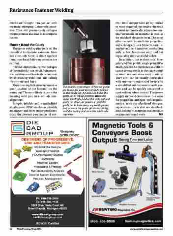

  teners are brought into contact with the metal stamping. Conversely, exces- sive force will prematurely collapse the projections and lead to incomplete fusion.
Flaws? Read the Clues
Excessive weld spatter in or on the threads of the fastener can result from low electrode force, a short squeeze time, poor head follow up or excessive current.
Thread distortion, or the collapse of the nut body, can result from exces- sive weld time—alleviate this condition by shortening weld time and raising the current and force.
Experiencing hole misalignment or poor location of the fastener on the stamping? The most likely cause is the locating weld pin, or electrode mis- alignment.
Simple, reliable and standardized single-point RPW machines provide an answer and solve many problems. Once the process parameters of cur-
The dolphin-nose shape of this nut guide pin keeps the weld nut centrally located on the guide pin. Air pressure holds the guide pin in the up position. When the upper electrode pushes the weld nut and guide pin down, air passes around the guide pin to blow away any weld spatter, help prevent the guide pin from sticking, cool the tooling and minimize electrode- cap wear.
