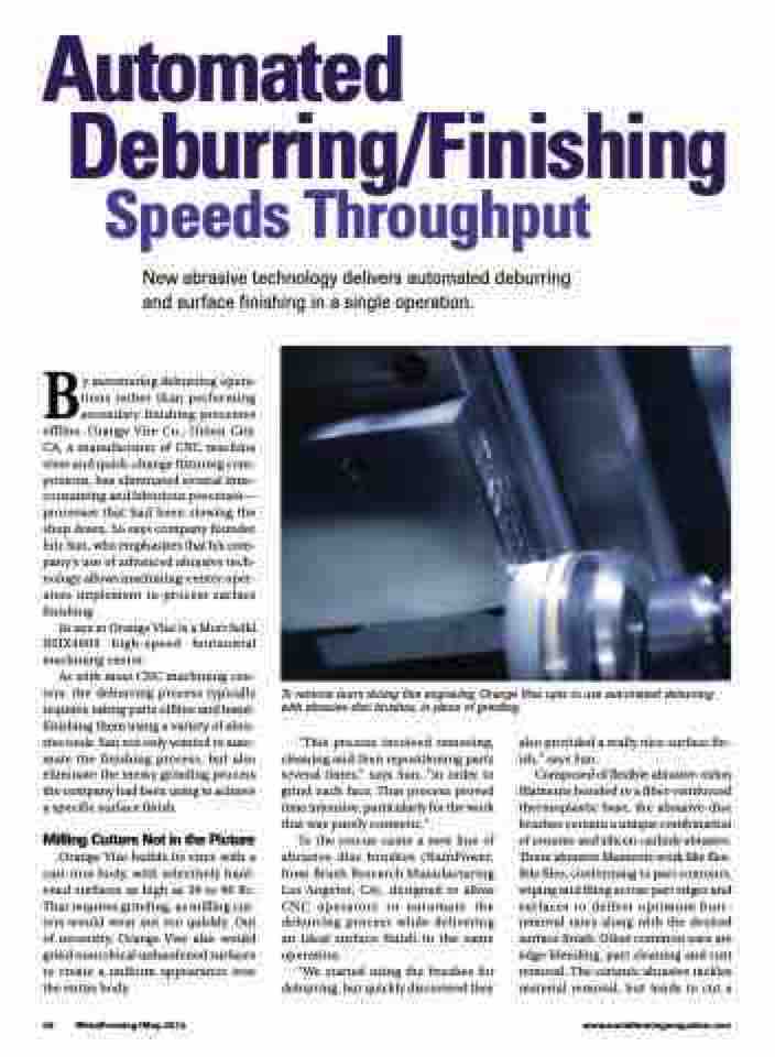

To remove burrs during fine engraving, Orange Vise opts to use automated deburring with abrasive disc brushes, in place of grinding.
