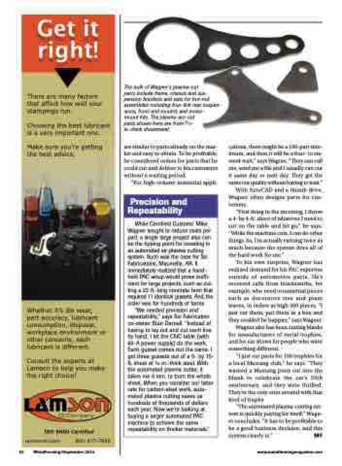

The bulk of Wagner’s plasma-cut
parts include frame, chassis and sus- pension brackets and tabs for hot-rod assemblies including four-link rear suspen- sions, front-end mounts and motor-
mount kits. The plasma-arc-cut
parts shown here are from 3⁄16-
in.-thick sheetmetal.
