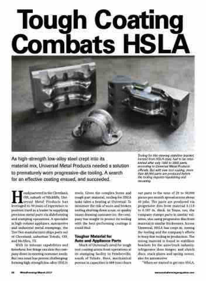

Tough Coating Combats HSLA
 As high-strength low-alloy steel crept into its
material mix, Universal Metal Products needed a solution to prematurely worn progressive-die tooling. A search for an effective coating ensued, and succeeded.
Tooling for this steering stabilizer bracket, formed from HSLA steel, had to be refur- bished after only 1000 to 2000 parts, according to Universal Metal Products officials. But with new tool coating, more than 80,000 parts are produced before the tooling requires repolishing and recoating.
out parts to the tune of 20 to 50,000 pieces per month spread across about 40 jobs. The parts are produced via progressive dies from material 0.118 to 0.187 in. thick. In Texas, too, the company stamps parts in similar vol- umes, also using progressive dies from material in similar thicknesses. Across Universal, HSLA has crept in, testing the tooling and the company’s efforts to keep that tooling in production. The strong material is found in stabilizer brackets for the auto/truck industry; refrigerator door hinges; and clutch discs, stack plates and spring covers, also for automotive.
