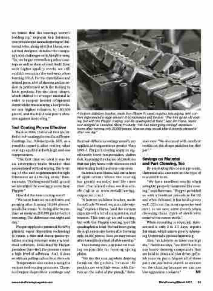

A bottom stabilizer bracket, made from Grade 70 steel, requires side wiping, with cor- ners experienced a large amount of compression and tension. “This tore up an old coat- ing, but with the Phygen coating, tool life quadrupled at least,” says Jim Harsa, senior tool designer at Universal Metal Products. “We had been going through expensive forms after forming only 20,000 pieces. Now we may recoat after 6 months instead of after one day.”

“A bottom stabilizer bracket, made from Grade 70 steel, requires side wip- ing,” explains Harsa, “and the corners experienced a lot of compression and tension. This tore up an old coating, but with the Phygen coating, tool life quadrupled at least. We had been going through expensive forms after forming only 20,000 pieces. Now we may recoat after 6 months instead of after one day.”
