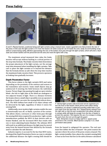

   D and E—Physical barriers, positioned along with light curtains using a manual reset, create a guarded zone that protects the rear of the press. In this case the light curtain is 5 ft. from the hazard. An entire scrap bin can fit inside the zone, easily accommodating scrap without compromising safety. Workers approaching the rear of the bolster must pass through the light curtains, which will enter a fault state and remain faulted until the personnel exit the area and reset the lights with a key.
 Barrier guard

F—Vertical light curtains with horizontal remote segments pro- tect the front of the hazard. These photos were taken during installation; not shown is additional guarding added later to pre- vent reach from the feed side. An L-shaped barrier extends from the right side so that the part-escapement hole allows tall parts to escape while still being far enough from the line of hazard to protect the operator. This requires the use of a conveyor to bring the parts from the tool out through the guard.
Note: All barriers mount on heavy wall 8-in.-square posts anchored to the concrete. Mesh barriers comprise 1⁄4-in.-thick perforated-steel panels.
