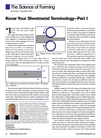

sheet thickness ranges from 0.2 to 6 mm. Plate refers to thicker material, while foil denotes thinner (Fig. 1). Some use the term ‘shate’ for aluminum from 4 to 6 mm, too thin to be called plate.
Fig. 1—Material can be referred to as sheet, plate or foil depend- ing on thickness.

Rolling comprises the next major processing step in the conversion of a slab or ingot to coiled sheet (Fig. 2). Here, thickness is reduced in a way similar to the use of rolling pins for flattening dough. Sheetmetal requires more rolling force than bread, so initial rolling occurs at a high temperature, hence the term hot rolling. Elevated temperatures deliver an easier way to make larger thickness reductions in succeeding passes. Because width does not change, the metal band elon- gates with every thickness reduction, while also increasing speed through the rolling mill. Most sheetmetal grades slow- cool in coil form, while faster cooling rates change the microstructure to increase strength. For at least some grades, hot-rolled alloys can carry the same strength and ductility as cold-rolled grades, but usually with different property ranges, wider dimensional tolerances and rougher surfaces.
Steel surfaces oxidize and create scale, a form of iron oxide that must be removed before further processing— performed by passing the material through acid in a pickling step. Rust-preventive oil added to the surface, if this is the desired end product, leads to the term “hot-rolled, pickled
Fig. 2—Rolling converts a slab or ingot to sheet.
  Plate
Foil
6 mm
0.2 mm
 Sheet
