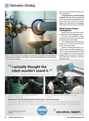

Faulty air-pressure gauges and regulators, as well as air-supply leaks, all can negatively affect grinder performance. These facets of the air-delivery systems should be checked to ensure proper operation.
