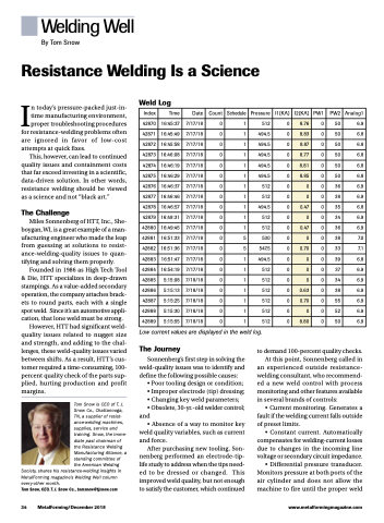

Weld Log
             Index
Time
Date
Count
Schedule
Pressure
I1(KA)
I2(KA)
PW1
PW2
Analog1
42870
16:45:37
7/17/18
1
512
 8.76
50
6.9
42871
16:45:49
7/17/18
1
494.5
 8.83
50
6.8
42872
16:45:58
7/17/18
1
494.5
 8.87
50
6.8
42873
16:46:08
7/17/18
1
494.5
 8.77
50
6.8
42874
16:46:19
7/17/18
1
494.5
 8.81
50
6.8
42875
16:46:29
7/17/18
1
494.5
 8.85
50
6.8
42876
16:46:37
7/17/18
1
512
36
6.9
42877
16:46:46
7/17/18
1
512
38
6.9
42878
16:46:57
7/17/18
1
494.5
 0.47
35
6.8
42879
16:49:31
7/17/18
1
512
34
6.9
42880
16:49:45
7/17/18
1
512
 0.47
36
6.9
42881
16:51:33
7/17/18
5
530
38
7.0
42882
16:51:36
7/17/18
5
547.5
 0.70
33
7.1
42883
16:51:47
7/17/18
1
494.5
39
6.8
42884
16:54:19
7/17/18
1
512
37
6.9
42885
5:15:08
7/18/18
1
512
34
6.9
42886
5:15:13
7/18/18
1
512
 0.63
38
6.9
42887
5:15:25
7/18/18
1
512
 0.70
55
6.9
42888
5:15:30
7/18/18
1
512
52
6.9
42889
5:15:55
7/18/18
1
512
 8.80
50
6.9
                                                              Low current values are displayed in the weld log.
