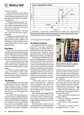

   Force vs. Amps (Tip Force 490 lb.)
20 18 16 14 12 10
8 6 4 2 0
Sample Data Lower Amp Limit   Lower Pull-Force Limit   Expulsion Limit   Ideal Amp Setting
   Expulsion
            No Nugget
Nugget
  0 2 4 6 8 10 12 14 Amps (kA)

Also, he performed a process study using a consistent weld pressure and various weld currents to find the opti- mum current setting (see Force vs. Amps graph).

Graph shows the results of a process study using a consistent weld pressure and vari- ous weld currents to find the optimum current setting.
