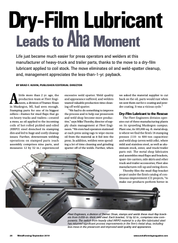

Fleet Engineers, a division of Tramec Sloan, stamps and welds these mud-flap brack- ets from 0.059-in.-thick mild steel. Each bracket, 12 by 32 in., comprises nine com- ponents. The switch from heavily oiled HRPO material to a dry-film-lubricated steel has returned significant process improvements in the firm’s metal shop, including less mess in the pressroom and improved weld quality and appearance.
