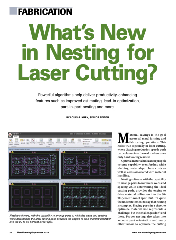

 Nesting software, with the capability to arrange parts to minimize webs and spacing while determining the ideal cutting path, provides the engine to drive material utilization into the 80 to 90-percent sweet spot.
