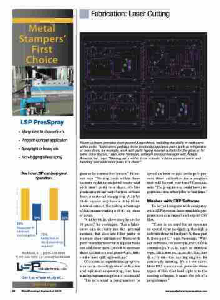

Newer software provides more powerful algorithms, including the ability to nest parts within parts. “Fabricators, perhaps those producing appliance parts such as refrigerator or oven doors, for example, work with parts having internal cutouts for the glass or for some other feature,” says John Parenzan, software product manager with Amada America, Inc., says. “Nesting parts within those cutouts reduces material waste and handling, and adds more parts to a sheet.”
glass or for some other feature,” Paren- zan says. “Nesting parts within these cutouts reduces material waste and adds more parts to a sheet...it’s like producing those parts for free, at least from a material standpoint. A 20 by 20-in. square may have a 10 by 10-in. internal cutout. Not taking advantage of that means wasting a 10-in.-sq. piece of scrap.
“A 48 by 96-in. sheet may be set for 10 parts,” he continues. “But a fabri- cator can not only use the internal cutouts, but also use filler parts to increase sheet utilization. Users with parts manufactured on a regular basis can add these parts to nests to increase sheet utilization and green-light time on the laser cutting machine.”
