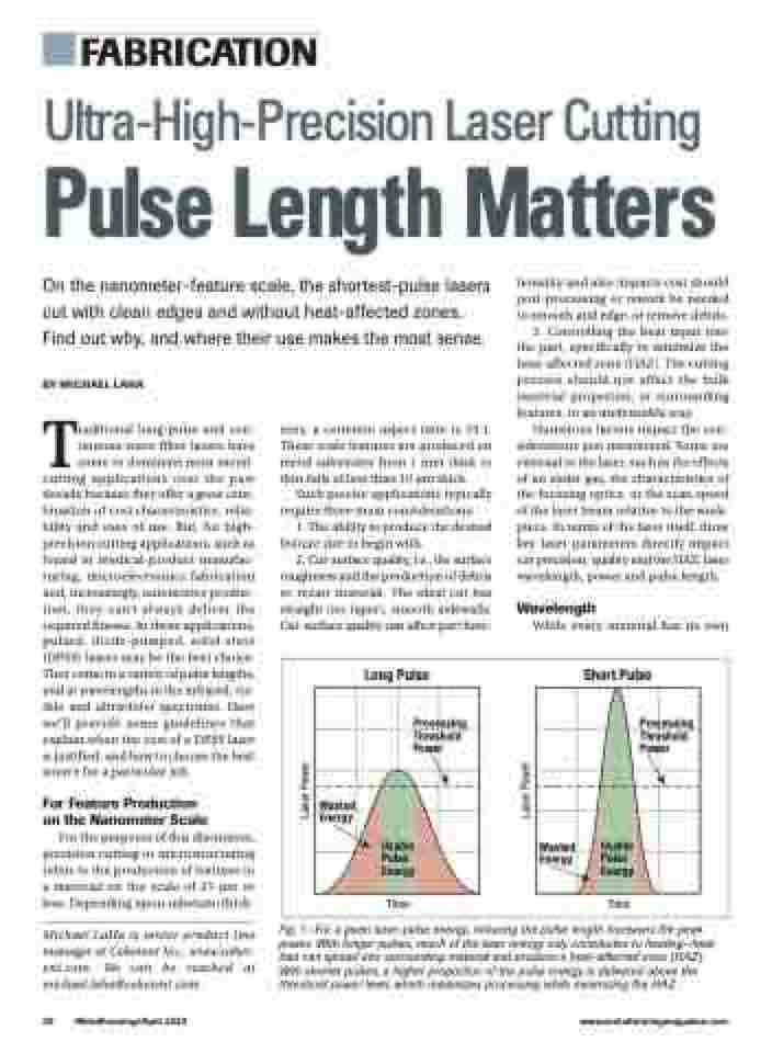

3. Controlling the heat input into the part, specifically to minimize the heat-affected zone (HAZ). The cutting process should not affect the bulk material properties, or surrounding features, in an undesirable way.
Numerous factors impact the con- siderations just mentioned. Some are external to the laser, such as the effects of an assist gas, the characteristics of the focusing optics, or the scan speed of the laser beam relative to the work- piece. In terms of the laser itself, three key laser parameters directly impact cut precision, quality and the HAZ: laser wavelength, power and pulse length.

Traditional long-pulse and con- tinuous-wave fiber lasers have come to dominate most metal- cutting applications over the past decade because they offer a great com- bination of cost characteristics, relia- bility and ease of use. But, for high- precision cutting applications, such as found in medical-product manufac- turing, microelectronics fabrication and, increasingly, automotive produc- tion, they can’t always deliver the required finesse. In these applications, pulsed, diode-pumped, solid-state (DPSS) lasers may be the best choice. They come in a variety of pulse lengths, and at wavelengths in the infrared, vis- ible and ultraviolet spectrums. Here we’ll provide some guidelines that explain when the cost of a DPSS laser is justified, and how to choose the best source for a particular job.

 26 MetalForming/April 2020
Fig. 1—For a given laser-pulse energy, reducing the pulse length increases the peak power. With longer pulses, much of the laser energy only contributes to heating—heat that can spread into surrounding material and produce a heat-affected zone (HAZ). With shorter pulses, a higher proportion of the pulse energy is delivered above the threshold power level, which maximizes processing while minimizing the HAZ.
