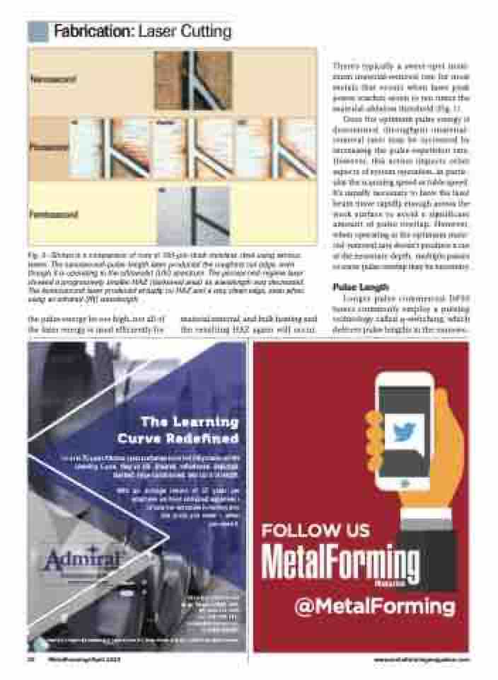

 Fig. 3—Shown is a comparison of cuts in 100-μm-thick stainless steel using various lasers. The nanosecond-pulse-length laser produced the roughest cut edge, even though it is operating in the ultraviolet (UV) spectrum. The picosecond-regime laser showed a progressively smaller HAZ (darkened area) as wavelength was decreased. The femtosecond laser produced virtually no HAZ and a very clean edge, even when using an infrared (IR) wavelength.
