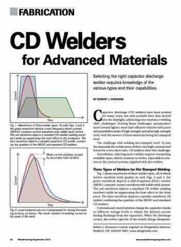

Fig. 1—Waveforms of three welder types. As with Figs. 2 and 3, the green waveform depicts a mid-frequency direct-current, (MFDC) constant-current waveform with stable weld current. The red waveform depicts a standard CD welder yielding excel- lent welds by suppressing the heat effect to the workpiece. The blue waveform depicts a variable-waveform CD welder combin- ing the qualities of the MFDC and standard CD welders.

Fig. 1 shows waveforms of three welder types, all of which deliver excellent weld quality. As with Figs. 2 and 3, the green waveform depicts a mid-frequency direct current (MFDC) constant-current waveform with stable weld current. The red waveform depicts a standard CD welder yielding excellent welds by suppressing the heat effect to the work piece. The blue waveform depicts a variable-waveform CD welder combining the qualities of the MFDC and standard CD welders.
Conventional control systems charge the capacitive banks to different voltage levels to obtain the desired current during discharge from the capacitors. When the discharge occurs, the entire capacity of the stored charge dissipates.

Fig. 2—Load variations are not compensated for during the weld- ing process, as shown. The result: variation in welding current at the peak of the weld.
