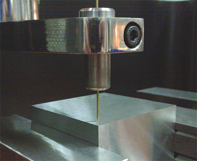

Similarly, a wire-EDM operates by sending an electrical charge through a wire into a piece of raw material. The material burns a slowly to create the part.
Both EDM processes can generate flammable gases during machining. The type and quantities of gases produced vary depending on the dielectric fluid, material being machined, and operating temperature, current and voltage.
Proper dielectric fluid level is of utmost importance for safe EDM operations. The fluid level should never drop below a point that would allow gas from the spark region to contact the air. The level should als be high enough to allow gas produced in the discharge region to form a bubble before it breaks to the atmosphere. Equip machines with a switch that triggers and stops the machine if the fluid drops to an unsafe level.
