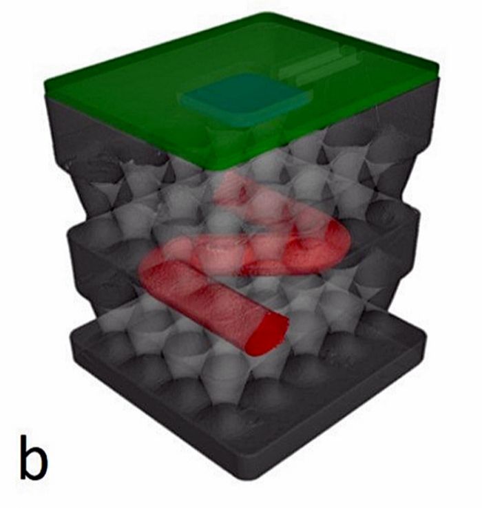

The work resulted in the fabrication of several robust, multiprocess, multi-material hybrid AM components with embedded sensors. X-ray computed tomography revealed that the sensors were successfully embedded in the metallic component and remained intact (Fig. 2a). Upon further testing for high-temperature resistance, parts were placed in a box furnace and heated to 500 C, and the sensors survived the temperature cycling and provided accurate temperature measurements.
