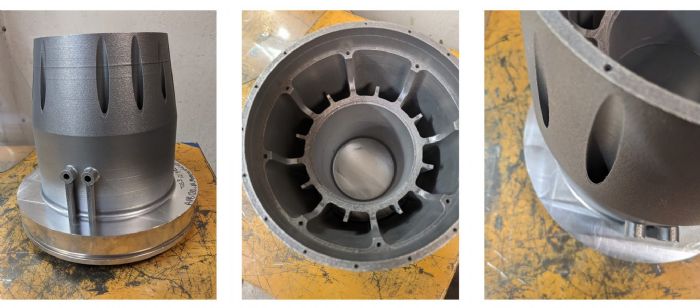

Fig. 1-nTopology-KW-resultsRecently, KW Micro Power employed software and expertise from nTopology to redesign for additive manufacturing (AM) the housing of its aerospace-grade, compact turbogenerator. The result: an AM solution that reduced the housing’s weight by 44 percent, with a total weight savings of 4.5 kg, and delivered exceptional cooling improvements. The housing is printed as a single piece on a Velo3D Sapphire AM system, replacing the original process of CNC machining, with aluminum F357 as the part material.

Fig. 2-nTopology-KW-coolingOver the past five years, Enrique Enriquez, president of KW Micro Power, has worked to create a microturbine generator roughly the size of a microwave oven that can crank out more power than systems 10 times as large. No stranger to aerospace design and manufacturing, in his career he has led engineering teams at Rolls-Royce, worked with DARPA on microturbine propulsion systems for the first vertical-takeoff-and-landing drone, and bought the second 3D printing system ever manufactured by Stratasys. Even so, the capabilities of contemporary design software and AM systems leave him wide-eyed.
