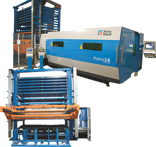

Rock Run uses the fiber laser and compact tower it acquired in March 2016 to cut a range of steels and aluminum, including highly reflective materials of various thicknesses (11 to 16 gauge) for its RV products as well as the 16-gauge galvannealed steel for its outdoor kitchen cabinetry.
Rock Run also benefits from the 10-shelf tower for loading and unloading blanks and processed sheets. The tower has an elevator for loading and unloading the pallets on and off the tower, and features single-sheet separating and sheet reference. In addition, because the machine is fully independent, it is suitable for lights-out operation. Once programmed, the fiber laser automatically manages settings, tip replacement, sheet change and storage, etc.
“We bought the 10-shelf compact tower because we don’t have a lot of room in our shop and also wanted to perform lights-out production,” says Schlabach. “The fiber laser and tower have a small footprint (30 by 30 ft.) that fits our shop. It has allowed us to bid jobs and be confident that we have the capacity to complete the job on time. If needed, we can run the unmanned extra shift on the laser without adding people.”
