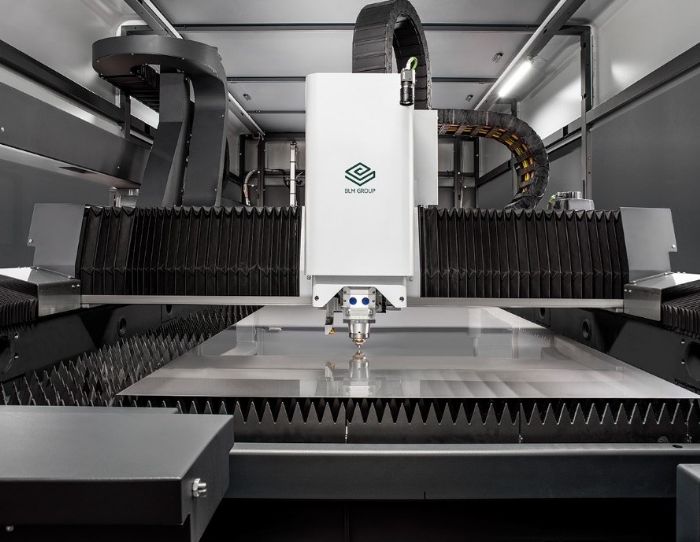

blm-group-ls7-laser-cutterBLM Group will demonstrate its LS7 laser-cutting machine at FABTECH, the latest sheet laser in its lineup, which will be coupled with an automated load/unload system.  The LS7 is available with laser power to 12 kW to cut steel, stainless steel, iron, copper, brass and aluminum in thicknesses from 0.20 to 1.57 in., or even double sheets, depending upon the material and selected laser power. It is available in two versions—the 3015 with a maximum sheet size of 121.5 by 62.2 in., and the 4020, capable of handling sheet sizes to 162.5 by 79.5 in.
The LS7 offers an axis acceleration to 2g to optimize processing cycles and minimize downtime. Plus, the fully electric pallet change helps to increase productivity by providing an average of 10 pallet changes/hr.
As shown at FABTECH, automatic sheet loading and unloading is available for the LS7, which can accommodate one or two storage towers for automated material-type and thickness changeovers, which is especially well-suited for unmanned operations.
