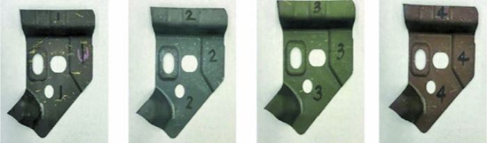

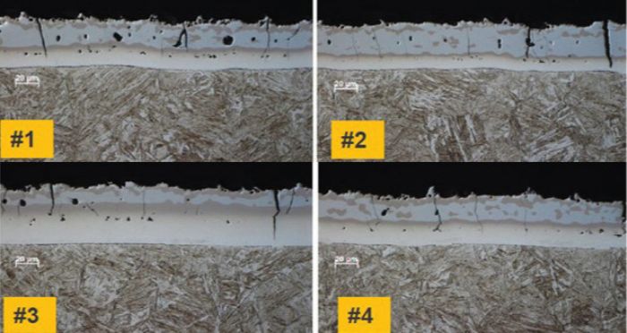

Fig. 2We easily can spot these differences in HSBS resistance as the materials have a slight change in appearance (Fig. 1, parts pulled from the same bin are of four distinctly different colors). This creates a moving target with regard to resistance each time that we try to weld a fastener to these parts, a target difficult to hit when using conventional mid-frequency direct-current (MFDC) weld controls because they supply constant current and generate inconsistent heat at the weld interface. The result: Fasteners may fail pushout requirements and potentially fall off. Also noteworthy: Even though the coating is very inconsistent, the base metal holds its desired integrity.

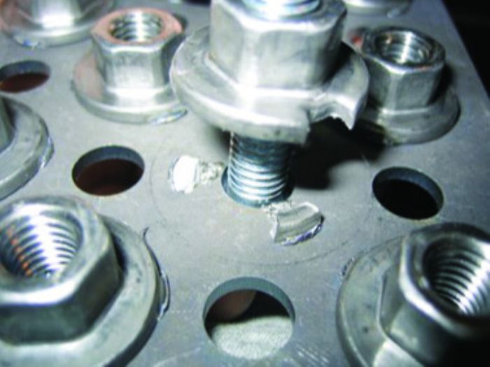

Fig. 3Metal formers also typically overlook and fail to account for the difference in the hardness of the HSBS and the fastener itself. According to the best data we can obtain from fastener manufacturers, fastener tensile strength ranges from 400 to 450 MPa, a stark contrast from the 1500-MPa tensile strength of formed HSBS. This means that traditional destructive testing can be difficult to gauge; we have seen fasteners fail before the base metal, which can result in anomalies in the final pushout-test data.

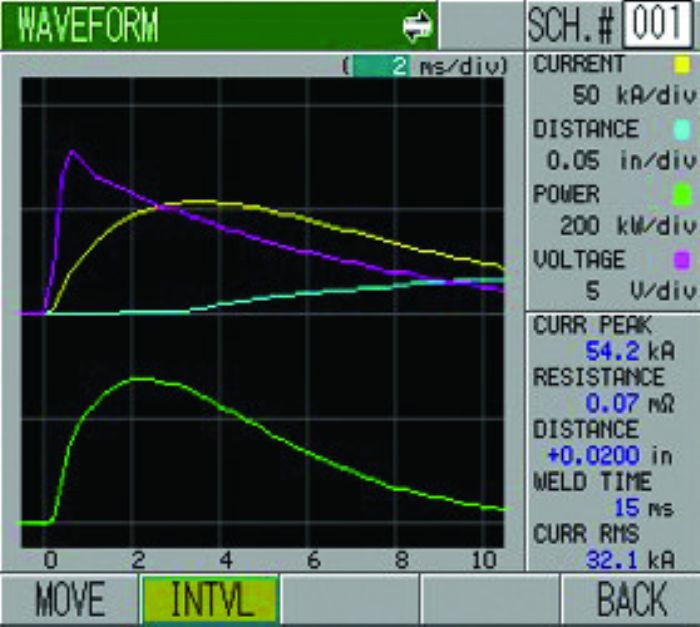

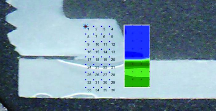

Fig.5Fig.6CD welding uses the energy stored in a bank of capacitors to deliver energy to the weld. A capacitor bank of a specific capacity (C) is charged to a high voltage (V), where the energy available to the weld secondary, E:
E=1/2CV².
Fig.7Fig.8Because C is fixed, the voltage is adjusted to change the energy available to the weld. For each weld to form using the same energy level, the capacitors are charged to the same voltage. That fixed amount of energy stored in the capacitors then is applied to the primary side of the weld transformer, and the transformer steps down the voltage to a level appropriate for welding.
Note, however, that the current delivered to the weld on the secondary side of the transformer is not fixed or controlled. Ohm’s law tells us that V=IR; the current on the secondary side equals voltage applied divided by the resistance of the secondary (I = V/R). As resistance increases, current decreases. The inverse also is true—as resistance decreases, current increases.

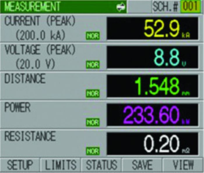

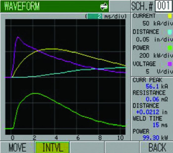

This makes the CD weld control the perfect tool for welding fasteners to HSBS base material. Fig. 5 shows the current output from a CD welder with an 8-mm fastener at 680 V programmed, and Fig. 6 shows the current output from a CD welder welding through a ½-in.-thick copper bar—without a fastener—also at 680 V programmed. While this is a somewhat dramatic representation on how the CD weld control works, we only collect this data to benchmark each welding machine before it leaves the shop floor.

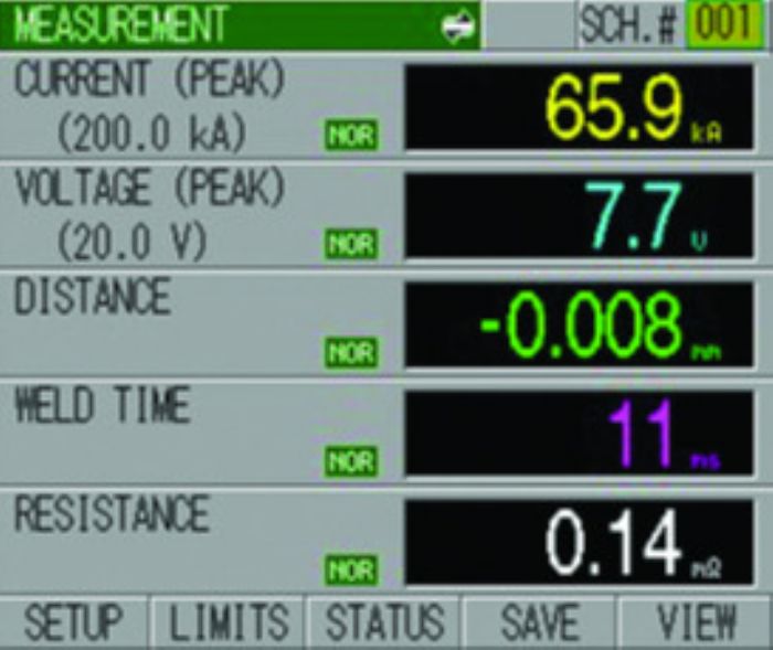

Finally, Fig. 7 shows real data from a single machine using an actual application. Notice the difference between the current and resistance readings—each weld has a different resistance signature and, therefore, a different current output.
