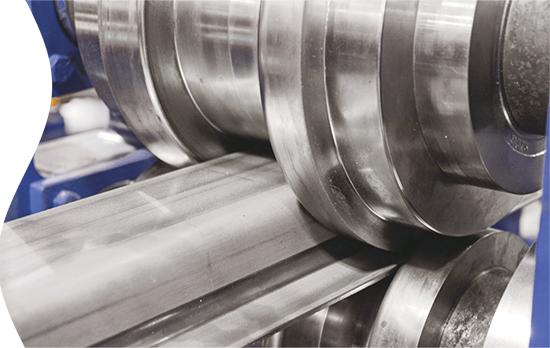

Before production begins, carefully evaluate assembly drawings, part geometry and mating components, and identify ways to simplify the product. Eliminate excess notches or multiple bends in a part, and consider ways to reduce the need for fasteners or laser-cut components.
Designing for rollforming also presents new opportunities that challenge other production methods.Complex sections often require multiple hits and several production processes to achieve a desired profile. Rollforming often eliminates much of this excess due to its ability to form complex linear shapes and perform secondary operations inline. Rollforming also is well-suited for parts requiring edge conditioning as well as long parts—the process accommodates part lengths beyond 50 ft.
Evaluating how a part’s design can be simplified and optimized for rollforming will reduce costs down the line, and improve efficiency and product quality. Tooling costs often deter fabricators from traveling the rollforming road, but options exist to reign in this expense.
Material selection for a new part or product comprises a crucial element of cost control and design integrity. For rollforming to be most effective, opt for light-gauge high-strength low-alloy or structural steel—material whose physical condition can be manipulated during the rollforming process without losing strength.
More and more, steel is fabricated via rollforming. Stronger steels, at thinner gauges, translate to less material content in a part while maintaining physical properties and strength. This allows fabricators to heat, cool, melt, mold, bend, punch and stamp the material into the desired profile.

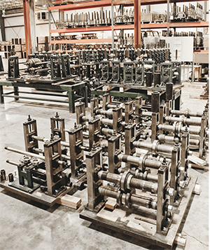

For custom shapes, rollform tooling can be engineered to form quality, cost-effective profiles. But escalating tooling costs have deterred manufacturers from the rollforming process.
Some manufacturers have turned to partial tooling investment, which ties up capital on the shop floor. This arrangement often requires additional payment or fees if the manufacturer wishes to use another supplier or bring production inhouse.
Minimize the tooling’s business impact by amortizing costs, which stabilizes cash flow while gaining the benefit of a high-volume, long-term production solution. Choose a fabricator that allows you to spread out the investment over time, without accruing interest.
