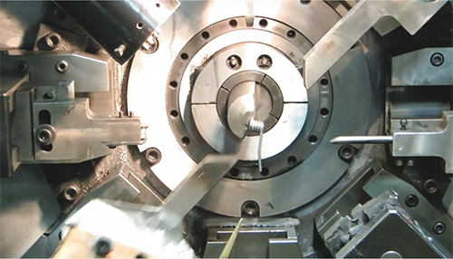

The designer also should understand how the springs will be assembled to their mating parts. When designing torsion and extensions springs, for example, an enormous assortment of end configurations can be shaped, using CNC technology, to precisely aid in the assembly process. By recognizing the spring’s complete installation requirements, the springmaker can ensure accurate assembly for crucial form and function.
