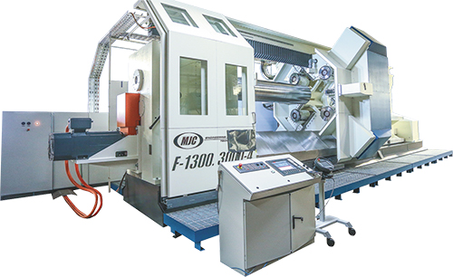

MJC Engineering and Technology, Huntington Beach, CA, engineers this CNC flow-forming machine using a Siemens Step 7 PLC control. The control software reflects the trend noted in the article—efficient communications, ease of programming, and enabling streamlined commissioning and service.
