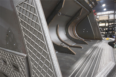

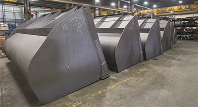

Resulting from the detailed consultation and planning was a custom overhead gantry system employing two Fanuc robotic arms. In action, the robotic system welds large buckets, to 22 cubic yards and weighing as much as 28,000 lb., for use in quarries and steel mills.
The entire robotic-welding assembly was mounted in a 5-ft.-deep pit, 40 ft. long by 20 ft. wide and dug into the ACS factory floor to keep the 26-ft.-high assembly under the overhead crane. The system welds the bucket in six different axes, with a variety of wire diameters at each axis, starting with as little as 0.035 in. dia and going up to 1⁄16-in. dia.
With efficiency improving from 60 to 80 percent since employing the custom robotic-welding system, ACS Industries has seen its bucket orders jump, according to company officials.
“We will do anywhere from 3⁄8-in.-thick fillet welds to 1-in.-thick groove welds that require multiple passes,” says Bob Willoughby, ACS president. “Above a 3⁄8-in. thickness are all multiple-pass welds that require multiple movements and multiple programs for all of the axes.
