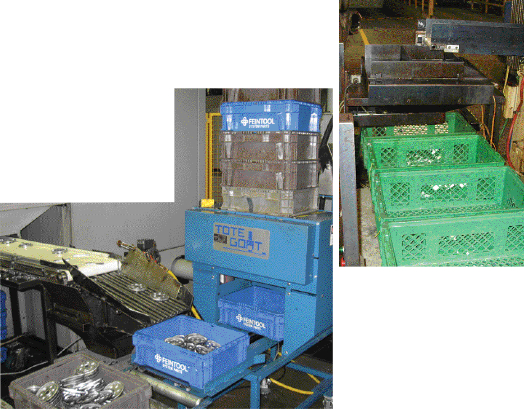

Manufacturers of packaging products and systems have developed a slew of new offerings in recent years, and Hardt offers that perhaps the biggest challenge a metalformer faces in moving to returnable packaging is simply keeping up with what’s new, evaluating the options and selecting the best products for the task at hand. Suppliers, for example, have developed bulk containers that collapse when empty to save money on return freight and storage. There also are reusable plastic containers designed to expand in any of three dimensions—height, width and length, to adjust to changing packaging requirements. Automatic tote-changing machines not only dispense totes of various sizes and speeds, but also include automatic part counters, level sensors and weight scales.
Hardt has several press lines at his facilities that employ automated packaging systems. Parts come off of the press and onto a conveyor that deposits them into returnable totes or containers. The packages are automatically weight-counted and, when full, move down the line and a new empty container is placed on the line. This minimizes labor and improves the accuracy of part counts to the customer.
“We’ve installed several new automated packaging lines in the last year alone,” Hardt says, “and also redesigned five manually operated packaging lines with automation. And, our goal is to redesign another four or five packaging lines this year. These projects primarily are for high-volume parts with high quality requirements, where improved packaging will improve PPM levels due to reduced damage from shipping and handling.”
Feintool engineers design the automated packaging systems themselves, and then work with suppliers to adapt their equipment to fit Feintool’s processes, including matching packaging equipment to conveyor sizes.

At Batesville Tool & Die, six of its 40 press lines include automated packaging systems, and several other lines employ operators to manually custom-load smaller reusable containers. Also, says Fledderman, there are instances where he cannot avoid repacking for customers—running into larger containers (maybe cardboard boxes) at the press and then repacking into smaller containers for shipping, an expensive process that also creates opportunities for mistakes.
Batesville’s automated packaging lines are designed and built inhouse. Conveyors loaded with plastic totes automatically index after so many press strokes. The firm designed the automated tote-changing lines to be easily moved from one press to another as needed, and they are adjustable to work with a variety of tote sizes. For those stampings where the customer requires parts stacked or oriented in a specific in the package (perhaps to prevent damage to the part or fit more parts into the package and minimize air space), the firm relies on operators stationed at the end of presses to carefully load containers.
