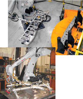

180-deg. rotating fixture table to feed a press. At left: A five-axis Motoman robot tends to a press at an appliance manufacturer. |

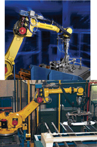

Neat blank stacks allow these Fanuc robots to cleanly destack blanks and load them into the first die station of a press. Where stacks are not so neat, stampers employ vision systems to view the blank as it is carriers by the robot and signal any necessary adjustments in blank orientation to ensure that the blank sits quickly and properly in the die. |
