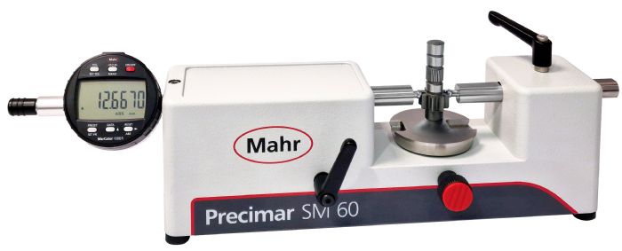

Mahr Inc., Providence, RI, a provider of dimensional metrology equipment, has expanded its Precimar SM 60 length-measurement product line with the introduction of the Precimar SM 60-V small-length measuring bench. This new version of the SM 60 is able to use Mahr’s standard contact inserts with 3.3-mm mounting. These inserts enable the unit to be individually adapted to a wide range of measuring tasks.
The Precimar SM 60 family features a measuring range of 60 mm, with a 25-mm sensitive contact and a fixed reference jaw with a 35-mm adjustment. The Precimar SM 60-V is equipped with a 5-N measuring force, and features robust construction for use in the production environment, meeting the demand for high-performance gaging at the point of manufacture. It also offers a simple setup for fast adaptation to new workpieces.
Interchangeable measuring inserts provide hardened steel or carbide surfaces in a variety of shapes, along with numerous thread-measuring options. An adjustable support table moves up and down to ensure proper part location and then locks into place.
