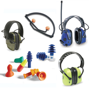

Offer a choice in HPDs, not just variety. OSHA requires that “a variety” of hearing-protective devices—earplugs and/or earmuffs—be made available at no cost to workers exposed to an 8-hr. TWA (time-weighted average) of 85 dB (85 dBA). But OSHA does not specify what constitutes “a variety,” and people’s ears are different. One earplug or earmuff style is unlikely to be suitable for all applications or even comfortable for the entire workforce. And comfort is the number one driver in HPD usage.
It’s a good idea, then, to offer choices, including different materials and styles designed for specific applications and/or worker preferences. These range from dielectric and cap-mounted earmuffs to “smart fitting” earplugs that conform to the shape of the user’s ear canal, multiple- and single-use earplugs, as well as banded earplugs that can quickly be inserted during intermittent noise. Earmuffs, too, come in a range of configurations.
