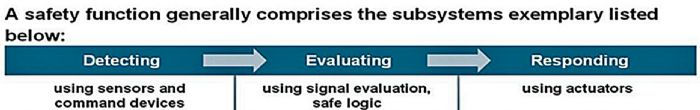

Safety-Related Parts of the Control
System
Metal formers must understand that the
circuit must be more than just the exclusive control device and its application
to the press safety-control system. The
device must be part of all safety-control systems responsible for the control
of hazardous energy, and each of those systems may include multiple safety
functions that the exclusive control device must be part of, as a detecting
device within the safety function.
Each safety function contains a minimum of three elements, as shown here.
Note: Each safety function must be analyzed to determine the
architecture (category level) for that specific function. Performance levels and control-reliability
analysis also can be used for the analysis.

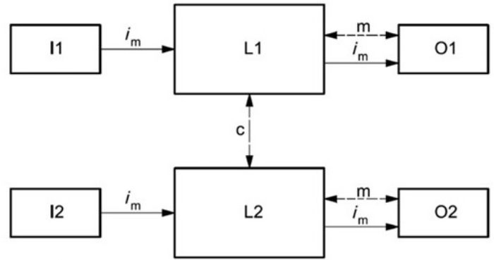

As previously noted, the OSHA interpretation for recognizing “properly designed safety-control circuits that provide effective protection for control of hazardous energy when using alternative methods for tasks” is based on the accepted methodology of the ANSI term control-reliable safety circuit. Per ANSI B11.26, a control-reliable safety circuit is a minimum of a category 3 circuit architecture--an architecture or design where “no single failure will cause the loss of the safety function.”
Per ANSI B11.26, the requirements for achieving
a category 3 circuit (see the diagram below):
Safety-related parts
of the control system of category 3 shall be designed so that a single fault in
any of these parts does not lead to the loss of the safety function. Whenever reasonably practicable, the
single fault shall be detected at or before the next demand upon the safety function:
- when
the single fault occurs the safety function is always performed,
- some
but not all faults will be detected,
- accumulation
of undetected faults can lead to the loss of the safety function.
- Note – item iii above is one of the reasons we perform documented periodic checks at regular intervals, the interval period determined by a risk assessment.
