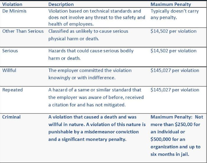

OSHA-inspection-violation-penaltiesIf your facility receives citations from OSHA, you should:
  • Post the citation in all areas in which the violation occurred. Citations must be posted for three working days or until the violation has been corrected, whichever is later.
  • Immediately notify your legal counsel about the citation and send them a copy of the citation.
  • Start the abatement process. Review all areas noted by the CSHO and all violations from previous inspections and correct any issues found within the timeframe stated on the citation. Document the corrections to show that you completed the abatement process.
  • Be sure to correct all hazards, or you may be assigned larger penalties during subsequent inspections.
  • Make note of all deadlines to avoid creating a short turnaround time for completing abatement measures.
