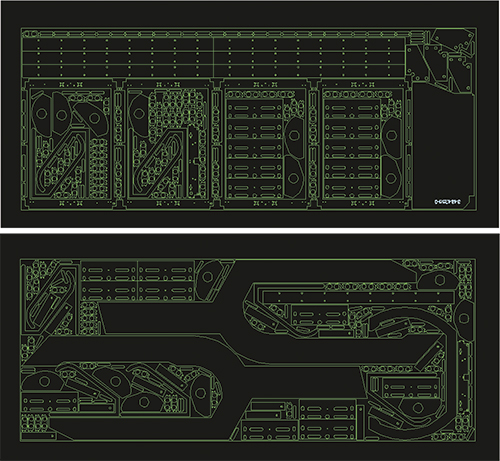

Lundy, commenting on a blog residing on the Optimation website titled, “8 Nesting Best Practices to Gain Productivity,” stresses the importance of dynamic batch nesting, so that fabricators can seamlessly and efficiently adjust their nests on the fly, during a shift. One best practice noted in the blog: Automatic batch nesting allows a fabricator to develop, just in time, optimal nests that consider the real-world manufacturing environment with all of its competing priorities, including ‘hot’ parts.
“With traditional batch nesting, when the orders for a particular shift change,” Lundy says, “and now include ‘hot’ parts that weren’t originally included on the nests, some of the nests that have yet to be produced must get called back and the ‘hot’ parts added. These nests must be reproduced with a new set of requirements, and that’s where dynamic nesting—and in particular automated just-in-time (JIT) nesting—comes into play.”
JIT nesting differs from traditional dynamic batch nesting in that it allows a fabricator to make adjustments to nests from one cycle to the next, by not ever building a batch nest. Instead, the nesting software allows the fabricator to automatically generate and deliver the next nest to the machine (a laser or turret press, for example) just before it finishes its current nest. So, with every machine cycle the fabricator can adapt to changing requirements on the shop floor.
“With JIT, a nest doesn’t get built until the machine is ready to run it,” Lundy says. “The nesting software draws from the active orders—including up-to-the minute changes and with ERP input as well—and creates the next nest. For example, consider a shop nesting in batch mode and running three lasers. If one of the machines goes down, there would be a series of nests backlogged; some might even include hot parts. With JIT nesting, the most important parts run through the remaining two machines automatically, avoiding production delays.

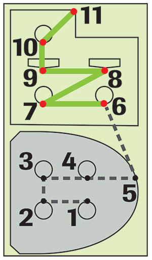

Nesting software with built-in collision avoidance creates nests and cutting procedures that avoid part tip-up and sheet buckling. The trick to collision avoidance: sequencing the tool path to minimize the number of times the cutting head must raise up to safely pass over previously cut paths and parts, which delivers the added benefit of eliminating slow z-axis motion that adds to processing time. |
“We’re seeing shops generate complex nests in less than 5 min.,” he adds. “This proves very challenging to the nesting software, which has to account for schedules, machine requirements and material efficiency. And, we see that JIT nesting improves material efficiency compared to batch nesting, because with batch nesting, fabricators will experience ‘tail-off’ where the last sheet in the run won’t be completely filled with parts, often creating remnants…and waste. With JIT nesting we can avoid the tail-off issue.”

“We also can make the clamps essentially disappear,” Lundy adds, “by nesting and programming machine action to punch where the clamps will be moving to, and then moving the clamps to that previously punched or cut location and punching where the clamps already have been. And, there’s built-in collision avoidance (particularly useful during plasma, laser and waterjet cutting),” he continues, “so that nests and cutting procedures are developed to avoid part tip-up and sheet buckling.”
The trick to collision avoidance: sequencing the tool path to minimize the number of times the cutting head must raise up to safely pass over previously cut paths and parts. This delivers the added benefit of eliminating slow z-axis motion that adds to processing time. In most applications, the nest should create tool paths that progress from the innermost cuts out toward the skeleton.
