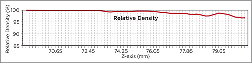

For example, most AM equipment generates data prior to the build, during calibration and setup, as well as during and after the build. This data can come in the form of text, csv, image or PDF files, depending on the platform being used for production. The challenging question: How does the AM shop use all of this data?
First and foremost, shops should put a robust data-collection and storage system in place that can capture all of the data and correlate it back to a specific build, as well as to each part within a build. Then, shops can analyze the collected data, in a meaningful way, using a handful of available tools, such as statistical-analysis software that can analyze large datasets and identify correlations. This exercise can be extremely useful and save an AM shop a lot of time and effort. Many companies also are developing their own analysis software specific to AM technologies.
At this point, the AM shop may have collected a lot of data and performed some amount of analysis. How, then, can it use the data to ensure consistent quality, as well as save time and money? This exercise hinges on the analysis of key process variables (KPVs)—the characteristics of the process that directly impact build quality. A producer must combine the information received through conventional inspection techniques with the output from the in-process data analysis to find correlations and identify which characteristics are true KPVs.
With the KPVs identified, the job then turns to establishing allowable values and tolerances for each KPV, and employing statistical process control (SPC). Shops can apply SPC in a variety of ways, but the most useful application initially rests on the use of control charts. A producer can maintain control charts with identified limits for each KPV to demonstrate that its process consistently meets the requirements.
