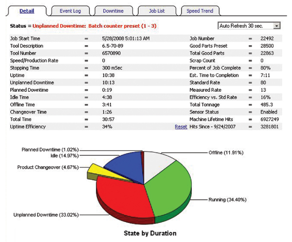

The Wintriss controllers use a novel approach to minimize the amount of reported idle time. Whenever a machine stops for more than a preset grace period (usually 1 min.), the controller automatically brings up the Dialog menu and prevents machine operation until an operator selects a downtime reason. When the operator selects the reason, the controller backfills the previous idle time with the real downtime cause.
The controller also requires the operator to respond to simple sensor, tonnage and other faults in a timely manner. If the operator does not clear an error within a preset amount of time, he must indicate the real reason for the stoppage. Whyis this necessary? Suppose a controller stops a machine due to a simple part-ejection error. The controller displays a “Part Ejection Sensor 1” error and reports it to the software. If the operator quickly fixes the error and restarts the machine, the short period of downtime will be attributed to a part-ejection fault and recorded by the software. However, if the operator is busy at another machine and takes 30 min. to respond to the part-ejection fault, logging all of that downtime to a simple sensor fault would be inaccurate. Instead, the control requires the operator to indicate via the Dialog menu the real cause for downtime, which in this case is “No Operator Available.”

At Waukesha Tool and Stamping, press operators carefully created the Dialog menu, with the most frequently used reasons placed near the top of the menu. In this case, the most frequently used reasons: “Multi Press,” indicating that the operator was unavailable due to responsibilities at another press, followed by “First PC Ins,” meaning that the machine was stopped awaiting first-piece approval.
That these were the leading causes for downtime did not surprise Clark and his team. What was surprising: Approximately one-third of the downtime occurring throughout the plant traced back to these two reasons. Like many manufacturers, Waukesha Tool and Stamping tries to do more with fewer people. In addition to running multiple presses, operators perform quality checks and assist in setup and troubleshooting, with quality-control personnel also stretched thin. Machines sat idle due to a lack of personnel available to perform simple tasks needed to keep them running.

Other downtime-reduction measures have little to do with personnel. For example, LETS showed that one high-volume machine stops an average of seven times per hour so that the operator can change the parts bin. These stoppages create 12 hr. of downtime per month, greatly lowering the machine’s efficiency and keeping the operator from addressing problems at other machines. Based on the cost of this downtime, Waukesha justified an automatic indexing system for the high-volume press, a system that automatically rotates an empty container into place based on a signal from the SmartPAC 2 controller. The operator can replace full containers with empties whenever he has the time, without stopping the press.

The LETS software helps in other s. The LETS Factory Viewer includes a detailed event log that provides a time- and date-stamped account of every event at every machine. Gary Rutkowski, Waukesha’s inhouse sensor expert, uses the event log to monitor recently sensored dies for nuisance faults and other startup problems that might otherwise go undetected. Rutkowski now can ensure that the sensors are employed on all shifts, and have not been bypassed or disabled due to excessive errors or nuisance stops.
