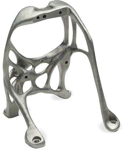

1) 3DMP provides the ability to create components that most directly embody and enable true design intent.
The freedom possible in the manufacturing process allows designers to create optimal designs without restrictions from conventional manufacturing processes. Shown is a metal bracket printed on a 3D Systems laser-sintering direct metal printer.
The freedom possible in the 3DMP process allows designers to create optimal designs without restrictions from conventional manufacturing processes. Design for manufacturability (DFM) has long been the method by which components were designed, and it subsequently drove design standards and practices by which compromises to performance, weight, cost, materials and other factors were necessary to result in a producible part. With additive manufacturing, the restrictions from DFM are greatly eliminated, allowing designers the freedom to create, optimize and push the limits of component development. As a result, designs become lighter, structural capabilities and product durability increase, products perform at higher efficiencies and temperatures, and assemblies are eliminated. All of these results combine to equal lower total cost.

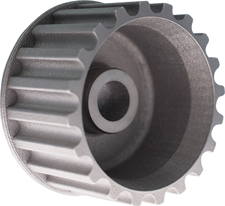

The ability of 3D metal printing to build parts directly from feedstock (metal powder, wire, etc.) eliminates the large investment in tooling lead time and cost found with other processes. Early in the development cycle of a product, the manufacturer can produce prototypes and end-use parts with minimal post-processing tooling, which accelerates times to market. Shown is a stainless-steel oil-pump pulley, created on a direct-metal printer.
