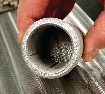

Here’s a 3D-printed Type 316L stainless-steel sleeve used on assembly lines to help balance transmissions. Made on a selective laser melting machine, it replaces a costly tool-steel predecessor that required extensive lead time for machining.

The impressive array of AM-produced products includes the first application off of the SLM stainless-steel machine: a sleeve used on assembly lines to help balance transmissions.
The tool slips over the input shaft of a transmission, allowing a technician to turn the transmission by hand via a ratchet attachment to spin and correctly balance and position the transmission. It’s made of 316L to replace a costly machined predecessor that required extensive lead time.
“These sleeves were made of a hardened tool steel and making them via 3D printing, we were concerned about the interior splines failing,” explains Brad Van Dike, Ford metal additive manufacturing specialist and responsible for the SLM machines at the center. “The AM material, 316L, is one of the softest stainless steels—kind of gummy. Rather than just making one, we made several in case the splines began wearing, and design and build took only about four weeks. Assembly workers only needed one sleeve to turn 100 transmissions, so it has worked out very well.”
The tool sleeve for balancing transmissions was made of a hardened tool steel “and making them via 3D printing, we were concerned about the interior splines failing,” explains Brad Van Dike, metal additive manufacturing specialist at Ford’s Advanced Manufacturing Center. “Rather than just making one, we made several in case the splines began wearing, and design and build took only about four weeks. Assembly workers only needed one to turn 100 transmissions, so the new tool has worked out very well.”

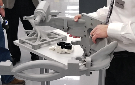

Lead time and cost savings peg the tool as an AM winner for Ford. And the wins don’t end there, as the redesign of a transmission-case gripper shows. Fitted on a robot arm, the lift-assist gripper proved unwieldy for assembly personnel and couldn’t adjust to handle larger transmissions. A redesign for AM made it more functional and also delivered almost a tree-branch appearance. The prototype has been printed in plastic and currently is under testing to validate its fit on the line. Once validated, the gripper will be produced in four or five pieces via the Desktop Metal printer, as opposed to perhaps 30-plus parts welded together using traditional manufacturing. And, the new AM gripper will allow for use of the same transmission pallets on the same line. Otherwise, Ford would need to buy new pallets and build a line extension, according to Sears, who estimates that the AM gripper can save Ford as much as $2 million.

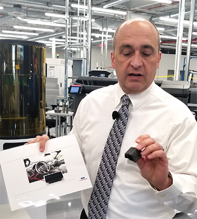

Ford’s very first production part, shown by Harold Sears, additive manufacturing technical leader for manufacturing at Ford Motor Co.’s Advanced Manufacturing Center, is a near-automotive-grade-plastic plug that inserts into the instrument panel for Ford Raptors destined for China. A dedicated machine at Ford prints 12 plugs in 1.5 hr., which works well now given the low current volumes.
Significantly, AM parts have entered Ford’s production arena. Ford’s very first AM production part: a near-automotive-grade-plastic plug that inserts into the instrument panel of Ford Raptors destined for China. A dedicated machine at Ford prints 12 plugs in 1.5 hr., which works well now given the low current volumes.

Fitted on a robot arm, a lift-assist transmission-case gripper proved unwieldy for assembly personnel and couldn’t adjust to handle larger transmissions. A redesign for AM made it much more functional and also delivered almost a tree-branch appearance. The prototype, shown here, has been printed in plastic and currently is under testing to validate its fit on the line. Once validated, the gripper will be produced in four or five pieces via a metal printer, as opposed to perhaps 30-plus parts welded together using traditional manufacturing. Officials estimate that the new gripper design will save Ford as much as $2 million.
