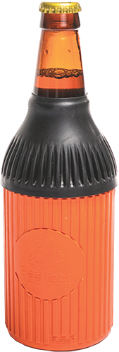

Metal AM can eliminate a large amount of shop time and circumvent the shortage of qualified labor when, for example, producing a core with complicated geometry, such as for this molded bottle sleeve. In such cases, EDM work may require a five-step process: design the electrodes, program machining of the electrodes, cut the electrodes, set up the EDM and then burn the core. Using metal AM, the BasTech team can program a metal-AM machine and let the core build over a weekend, accelerating the process and freeing employees for other work.
