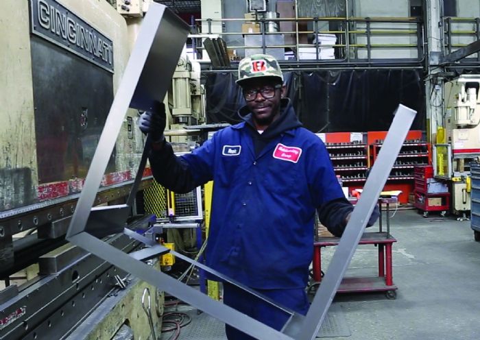

When NIMS began to work with MWG on its press brake-training program and pay-scale challenges, it sought a measurable way to bring everyone in the department to the same skill and pay level.
“We wanted pay to be based on ability and achievement,” says Mondillo.
NIMS started by working with MWG to define the duties necessary to ensure that the department would perform productively, daily. It organized duties into roles based on responsibilities, using these standards to drive the development of all training materials. For MWG, this process defined a skills hierarchy that featured three specific roles, each with a defined pay scale to eliminate subjectivity:
- Entry-level pedal pusher
- Mid- to advanced-level press brake operator
- Leadership-level press brake supervisor.
At this point, an evaluator was selected and trained to review employee performance and assign roles based on the ability to perform the duties listed. Pedal pushers, for example, stay at this level if they can perform some but not all of the duties within the role. They know exactly what they need to learn to become fully credentialed pedal pushers, and acquiring those skills require that they find opportunities within the regular production cycle to learn.
