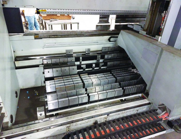

LVD ToolCell Tool Stadium Richards WIlcoxA pivotal player in Richards-Wilcox’s efficiency playbook, and its latest CI project: the addition, in July 2020, of a fully equipped hydraulic press brake (135-ton capacity, 12-ft. bed) with integrated automatic tool changer—a ToolCell from LVD Group. The machine’s six-axis modular backgauge features integrated grippers that load and unload tools from an on-board “tooling stadium” that stores two complete lengths of punches and five complete lengths of dies. Quick-acting hydraulic clamping with hardened inserts also helps to minimize changeover times, all setting the stage for a transformative journey towards a more automated and efficient forming operation.
“Quicker changeovers between jobs—as much as 50 percent quicker with the ToolCell—has that machine running at more than 90-percent uptime. That’s a dramatic improvement from our conventional press brakes that operate at 55 to 60 percent overall equipment effectiveness,” McMurtry shares. “That’s a tremendous accomplishment, as the part runs the ToolCell processes are very short—five to 50 parts. Some 80 percent of our work orders on the floor are fewer than 100 parts.”

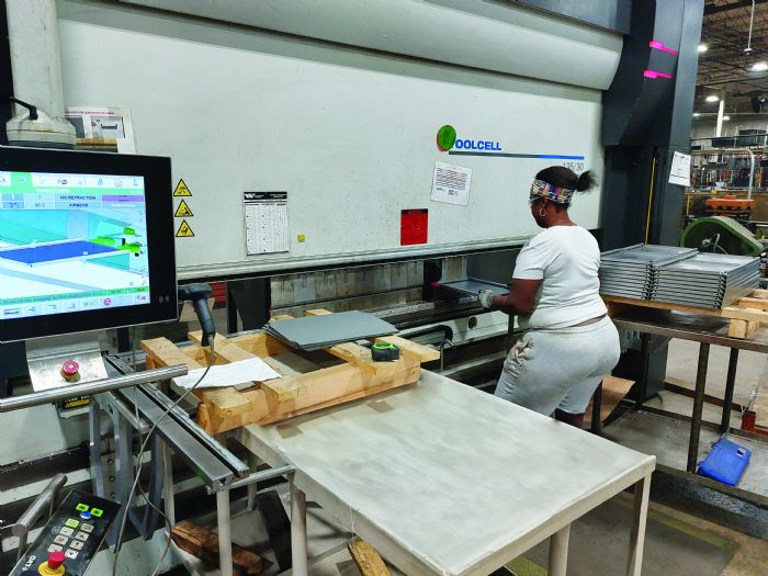

In addition to automating the tool-change process, production efficiency at the new press brake comes from the use of on-screen intuitive graphical icons to assist operators with parameter control, and offline programming via LVD’s Cadman-B bending software.
“We’ve programmed thousands of parts on the machine,” McMurtry says, “using a variety of tools, including LVD’s tall, higher-flange tools.” In addition, per LVD, the ToolCell features an extendable open height of 22.4 to 26.4 in., and extendable stroke from 11.8 to 15.7 in.

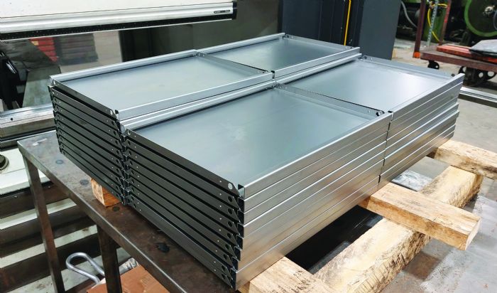

“The taller flange tools,” McMurtry says, “prove useful for bending drawers, which are 3 to 12 in. deep, for our storage units. We also recently ordered some new hemming tools for the ToolCell, as we have several products that require hemming. We’ve been performing hemming as a secondary operation on our manual press brakes, but we’ll eliminate that secondary process once we add the hemming tools to the ToolCell.”

  • Front supports and sheet followers—“Based on part size, of course, both of these features prove very useful,” says McMurtry. They allow the firm to tend to the ToolCell with one operator; larger parts that require more material-handling muscle route to the firm’s robot-tended panel bender.
  • LVD’s Easy-Form laser-based bend-angle control—“We use that feature, as called for in the bend program, to help ensure consistent bend angles from first to last part,” McMurtry adds.
