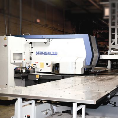

It’s bedlam, and before you know it, you’re in the bonus round. In fact, CNC punching machines, with the right tooling, can perform a variety of operations traditionally considered as press or press-brake work, or performed as secondary work in standalone stations. To explore such operations, MetalForming talked to Susan Erler, product manager of punching at Wilson Tool International, a provider of tooling technology for fabricating equipment.

CNC punching tools can bend to 90 deg. in heights to 1 in., and even overbend to combat springback.
Typically, 90-deg. bends bring to mind press brakes. But, according to Erler, many manufacturers don’t realize that they can execute these bends in a punching machine. Achieving 90-deg. bends in this manner eliminates costly and time-consuming secondary operations as well as associated material handling and transport. In addition, with the right tool, bends can achieve heights to 1 in., with overbends possible in order to combat springback.
“For example, Wilson Tool’s Opti-Bend tool employs a rotating cam built into the lower unit of the die,” Erler explains, “with the machine stroke mimicking a press-brake cycle. The tool, with its lower-cam design, allows for heights not typically achievable in a punching machine. On a turret press, the operation is not limited by the tool having to travel above or beyond the form as would be the case with a traditional lance and form of 90 deg. or even with a 90-deg. wipe.”
The Trumpf-style tool has achieved a 0.984-in. overall feature height, with the thick-turret version approaching a 0.600-in. feature height, reports Erler—even higher when upforming.
