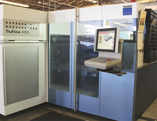

Republic Sales & Manufacturing installed this Trumpf TruLaser 3030 early in 2012. The machine’s technology package boasts three key features: automatic nozzle changer, a beam-alignment unit and automatic lens-status inspection. Also helping to justify the new-laser purchase is Republic’s ability to operate the machine unattended, thanks to Trumpf’s LiftMaster automated load/unload system.

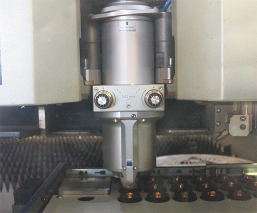

The TruLaser 3030 represents what Trumpf called, when introduced a few years ago, a “new design concept—one cutting head for all sheet thicknesses.” The machine’s technology package features lens and nozzle automation, designed to optimize laser-beam-on time and cut edge quality. The technology package’s three key features: automatic nozzle changer, a beam-alignment unit and automatic lens-status inspection. Also helping to justify the new-laser purchase is Republic’s ability to operate the machine unattended, thanks to Trumpf’s LiftMaster automated load/unload system.

Nozzle size simply becomes one more process parameter in the cutting program downloaded to the machine control as part of a job number. “To cut the full range of material types and thicknesses, we use six different nozzle diameters,” says Torres, “from 0.8 to 2.7 mm. The automated nozzle changer gets the job done in less than a minute, while manual nozzle changes take 5 min. or more. That feature alone provides about an hour of added production time every day.”
Republic laser-cuts mild- and stainless-steel work from 16 gauge to 3⁄8 in. thick, using six different assist-gas nozzle diameters. Thanks to the automated nozzle changer on the firm’s new cutting machine, it gains an extra hour of production time per shift.
