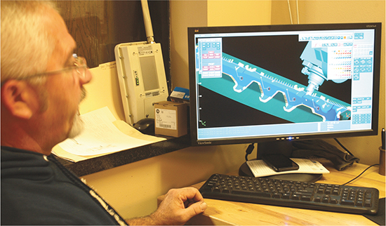

Accu-Rite programmer Mike Winkler explains how with just a few mouse clicks, programming moves from the CAD part model to cutting-fixture design (with supporting-rib geometry included), and on to cut-path formulation.
Accu-Rite programmer Mike Winkler explains how with just a few mouse clicks, programming moves from the CAD part model to cutting-fixture design (with supporting-rib geometry included), and on to cut-path formulation. The software considers cutting-machine and cutting-head kinematics and geometry to eliminate collision hazards.

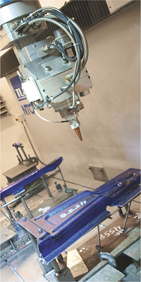

Amongst the tools in the firm’s proverbial manufacturing toolbox are, of course, stamping presses (350- to 750-ton hydraulic models), as well as press brakes, machining centers and coordinate-measuring machines. The newest star on its shop floor: a five-axis 3D laser-cutting machine, a TLH-series model from NTC America, with a work envelope of 177 by 45 by 20 in. Equipped with a 2-kW fiber laser, the state-of-the-art workhorse boasts cutting and positional accuracy rated to 0.0015 in., and a pallet changer to optimize throughput. It takes Accu-Rite’s ability to trim stamped prototype parts to a new level of efficiency and quality.

The newest star on the Accu-Rite shop floor is this five-axis 3D laser-cutting machine, with a work envelope of 177 by 45 by 20 in. and equipped with a 2-kW fiber laser.

Among the noted features in the Tebis laser-cutting CAM module, as noted by Accu-Rite programmer Mike Winkler: With just a few mouse clicks, programming moves from the CAD part model to cutting-fixture design (with supporting-rib geometry included), and on to cut-path formulation. The software considers cutting-machine and cutting-head kinematics and geometry to eliminate collision hazards, while also minimizing major rotational movements. Winkler employs the software to program all five of the firm’s 3D laser-cutting machines; machine data—physical dimensions as well as cutting-process capabilities —is contained within the Tebis database.
Winkler also notes that the CAM software minimizes laser-head approach and retract movements, “while ensuring the head isn’t spinning excessively,” he says. “We’re minimizing ‘air time’ and optimizing cutting time.”

With upgrades in collision avoidance and other features added to Tebis via recent software updates, programming is faster than ever—“maybe 30 percent faster than it was several years ago,” says Winkler, “and the process is more efficient. I’m confident that the programs developed in the office, offline, will run the first time on the shop floor. That means we’re not going back and forth from programming to production to fine-tune the lasers. This way, the cutting machines can work on the next job, making money, rather than waiting for program tweaks.”

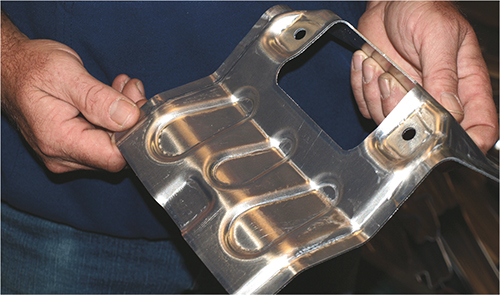

While most of Accu-Rite’s prototypes are of high-strength steel, its volume of aluminum stampings has been on the rise. Here, programmer Mike Winkler points out some of the tricky contours the five-axis laser-cutting machines must navigate.
While most of Accu-Rite’s prototypes are of high-strength steel, its volume of aluminum stampings has been on the rise. Here, programmer Mike Winkler points out some of the tricky contours the five-axis laser-cutting machines must navigate. The Tebis CAM software helps to ensure that the process meets the required tight tolerances on cut angle and edge quality.
Winkler says that he can program some of the shop’s simpler parts in just 15 min., and complex parts take only an hour or so of programming time.
Out on the floor, Accu-Rite laser-machine operators trust that Winkler’s programs will run correctly, the first time. “In the past,” says Winkler, “they used to dry-run every job with the cutting head retracted to a safe position, to ensure the programs were sound, and then make adjustments as needed. They no longer have to perform that wasteful step, which represents a huge time savings—probably 30 min. on every job.”
Should the operator on the floor, in that rare instance, need to make any modifications to the NC program at the machine, Winkler notes that those modifications can easily be reversed back into the NC job via its relatively simple editing functions.
