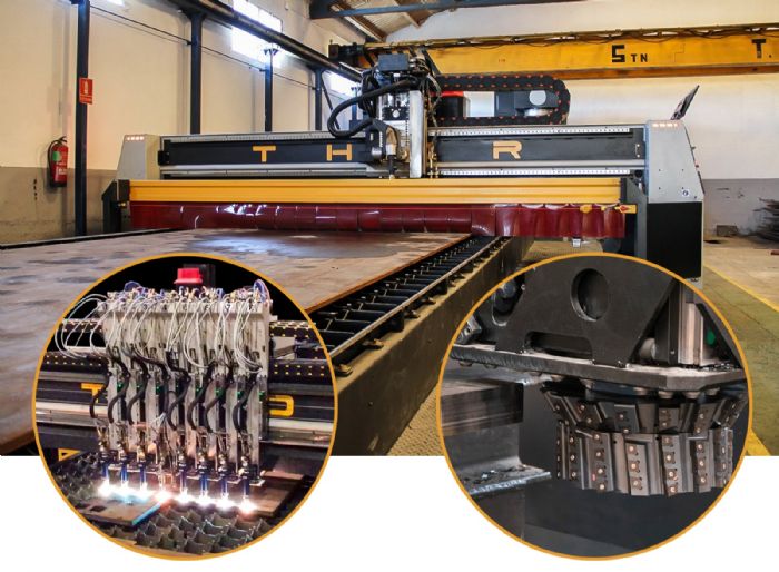

Tecoi USA features its Thor F (Tecoi Hyper Operative Range) plate-processing machine, designed for heavy-duty thermal-cutting applications and also having machining operations. It integrates plasma and oxyfuel cutting with an optional beveling system, and an optional tube and profile lathe. The Thor F machine also combines plate cutting with edge preparation and numerous mechanical machining operations, including milling, drilling, tapping, countersinking, marking, etc.
Plasma cutting operations include either one or two cutting heads and the optional beveling system, as well as oxyfuel cutting with as many as 12 torches, multiple marking options and the auxiliary tube and profile lathe. The Thor F has a central XX axis with a path of 24 in. working on a robust double-beam design. It completes machining tasks with a fixed gantry and the option to fit two machining heads, and it integrates a unique table design for plate thicknesses to 8 in. for thermal processing and drilling applications. Half of the cutting table is magnetic, holding plates in place during machining operations for single-pass edge milling during welding preparation of plates to 2 3/8 in. thick.
The machine features Tecoi’s exclusive Bevel Arc beveling system, accommodating angles of ±50 deg. with plasma or oxyfuel cutting. The machine also features Tecoi’s Driltec system for drilling and tapping with the option of an automatic tool charger, while offering CAT 50 tool storage for 5 to 32 tools. And, the machine’s cutting table can be equipped with dross collection under the grid and an independent chip-collection system for recycling.
