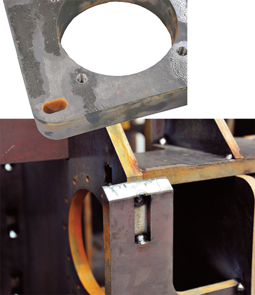

Two examples where the waterjet-cutting machine eliminates subsequent machining operations involve parts needing flange bearings and those requiring tapped holes. WaneShear uses several piloted flange bearings in its edging system. Rather than flame-cut and bore the parts to prepare for the bearings, the shop accurately waterjet-cuts the required features to the size and straightness needed for inserting the bearings as the parts exit the waterjet machine. No additional machining is needed.
For tapped holes, the 120X-3, says McGehee, cuts holes to tolerances tight enough to allow tapping without having to be drilled to size. The shop then quickly and easily taps the holes using a magnetic-base drill.

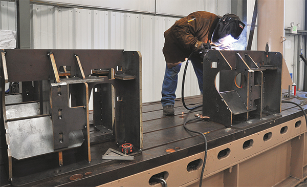

Quicker Weld Setups
The speed and accuracy delivered by the waterjet-cutting machine allows WaneShear to design its parts with features that help streamline the shop’s welding operations. For example, mating parts include waterjet-cut slots and keys to enable quick and easy weld fitup. For the shop, cutting these extra features on any other machine could prove cost- and time-prohibitive.
“It’s not only the waterjet-cutting machine’s speed but also its accuracy that makes this practice feasible,” says McGehee. “With waterjet cutting, we’re easily holding tolerances on these weld-locating features to within 0.001 to 0.002 in. As a result, our welders rarely have to reference blueprints or measure and scribe guide lines. The process basically involves inserting key A into slot B and welding, which makes the process quick and practically flawless.“
These fabrication features, notes McGehee, do not completely eliminate the need for welding fixtures. Some fixtures are required to keep parts square and plumb. However, custom fixturing is unnecessary, and most of the time the shop’s welders simply need only a flat table surface.

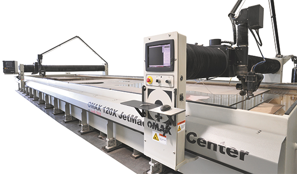

Cutting for Two Days Straight, Uninterrupted
As a critical tool in the shop’s manufacturing operations, the waterjet-cutting machine typically runs from 6:30 a.m. to 11 p.m. six days per week in the WaneShear plant. It occasionally operates in continuous production for as long as 48 hours, uninterrupted.
According to McGehee, no one at the shop had previous experience running an abrasive-waterjet machine. But with just a week’s worth of training from an Omax technician, the shop was able to get the machine up and running quickly. He adds that the Intelli-Max Software Suite “is so user friendly that it took only about 5 hours of programming instruction to train our operator. If a person knows how to turn on a computer, they can run the Omax.”
