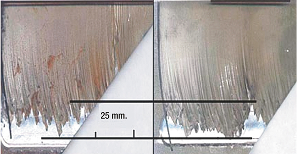

We set a performance requirement for each cut so that when a cut fell below a certain depth, we would consider the nozzle to have worn out. Results varied among nozzles, with operational life ranging from 10 to 40 hr. So while we do not necessarily recommend that fabricators perform the exact same test that we did, we do recommend you test various nozzle types to see how they perform for the range of materials and thicknesses typically processed.

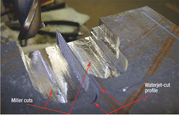

Lastly, a point of emphasis when working with our research teams is teaching them to conserve materials, starting with an understanding of optimum sheet nesting. Another to conserve material is to repurpose the next skeleton for cutting small parts from what otherwise would be tossed aside as scrap. Here we find yet another advantage of waterjet cutting over conventional milling, since milling turns the workpiece skeleton into chips to be sold as scrap.
