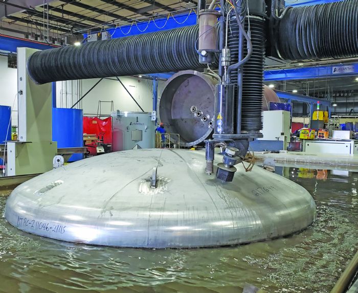

“We fabricate a lot of pressure vessels, as well as lifting lugs, gussets and other little pieces that we assemble to the vessels,” says Coleman. “Tube and pipe sections, too, and prior to the waterjet machine we often would hand-cut and manually drill holes rather than send the work outside. Now with the waterjet we can efficiently, and with much greater quality, provide our welding department with precision-prepped weld edges, making the welding process more efficient and also with optimum quality. I’ve cut domed vessel heads on the waterjet where the welders didn’t have to perform any edge grinding on the weld joints prior to welding.”

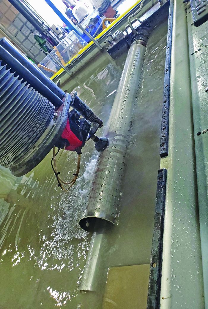

While the firm has a dedicated programmer using the IntelliMax software in the engineering office, two operators have been trained to program the cutting machine on the shop floor. They simply input into the machine control the material type and thickness, workpiece-to-mixing-tube offset and the required cut-quality level, and the control software calculates cutting speed.
While AvanTech bought the machine primarily to cut pressure-vessel and container plate and domed heads, it also equipped the machine with a rotary axis, useful for cutting and drilling holes in tube and pipe.
“Just this week we cut three 1-in.-thick domed heads and used the machine to cut out holes to accept three nozzles in each of the heads rather than task our welders with cutting those holes,” Coleman says. “Just the cut time on that alone saved our welders three days in terms of laying out a head, using a flame-cutting torch to cut the holes, and grinding to prep weld edges. With the waterjet we had the job completed in less than one shift.
