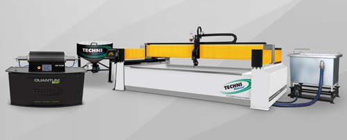

Waterjet cutting equipment at Captive Spark, a California custom-fabrication shop, enables precision-cut architectural panels, often within tolerances of ±0.005-in. |
Captive Spark, a custom-fabrication shop in Berkeley, CA, serves a finicky customer base requiring precision cutting, with expectations running high when it comes to aesthetics.
“Ninety percent of our work is for tech firms such as Dropbox, Amazon and Google,” says Alex Frith, owner of Captive Spark, a four-person operation. The company launched in 2001 as a one-person shop with “low-end welding equipment and a combination lathe/mill machine in a 1500-sq.-ft. space” where Frith modified road-racing motorcycles. As the company gained larger jobs, it added a plasma cutter but made the switch to waterjet cutting this summer when it installed an Intec-G2 waterjet cutting machine from Techni Waterjet, Charlotte, NC. Today the plasma-cutting equipment is used for projects that don’t call for tight tolerances, such as custom-railing and public-art projects.
“We’re using the waterjet for labor-intensive architectural metal (stainless, brass and copper) components such as custom reception desks and cladding for wood cabinets,” Frith says. “While we’re not making aerospace parts, we are producing sheet metal formed parts where ±0.005-in. tolerances are critical. If the flat pan isn’t accurate, neither will be the sides.
“The waterjet, a 5- by 10-ft. machine, makes for a small footprint, Frith continues. “The servo pump is efficient and its Tech-Sense feature monitors the cutting head and pauses the program if there are blockage issues, allowing us to run the machine unattended.”
